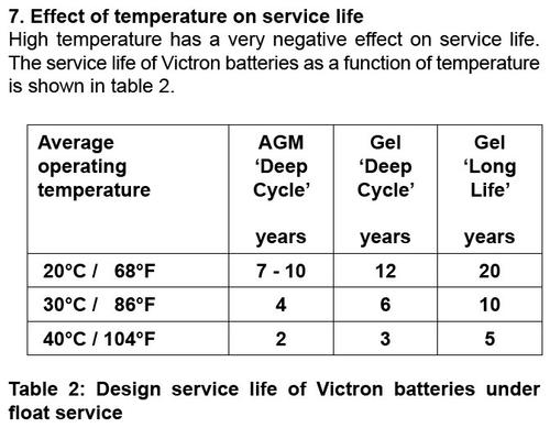

Det skulle vara intressant att få lite kunskap om att ett batteris livslängd skulle halveras om det tex används i en omgivningstemp på 35 grader.
Per
Bilden till höger är från http://www.dcmarine.se/files/Datasheet-Viktron-Batteries.pdf
http://www.mpoweruk.com/life.htm
The Arrhenius equation defines the relationship between temperature and the rate at which a chemical action proceeds. It shows that the rate increases exponentially as temperature rises. As a rule of thumb, for every 10 °C increase in temperature the reaction rate doubles. Thus, an hour at 35 °C is equivalent in battery life to two hours at 25 °C. Heat is the enemy of the battery and as Arrhenius shows, even small increases in temperature will have a major influence on battery performance affecting both the desired and undesired chemical reactions.
 http://www.discover-energy.com/files/shared/Discover_temperature_effects_charging.pdf
