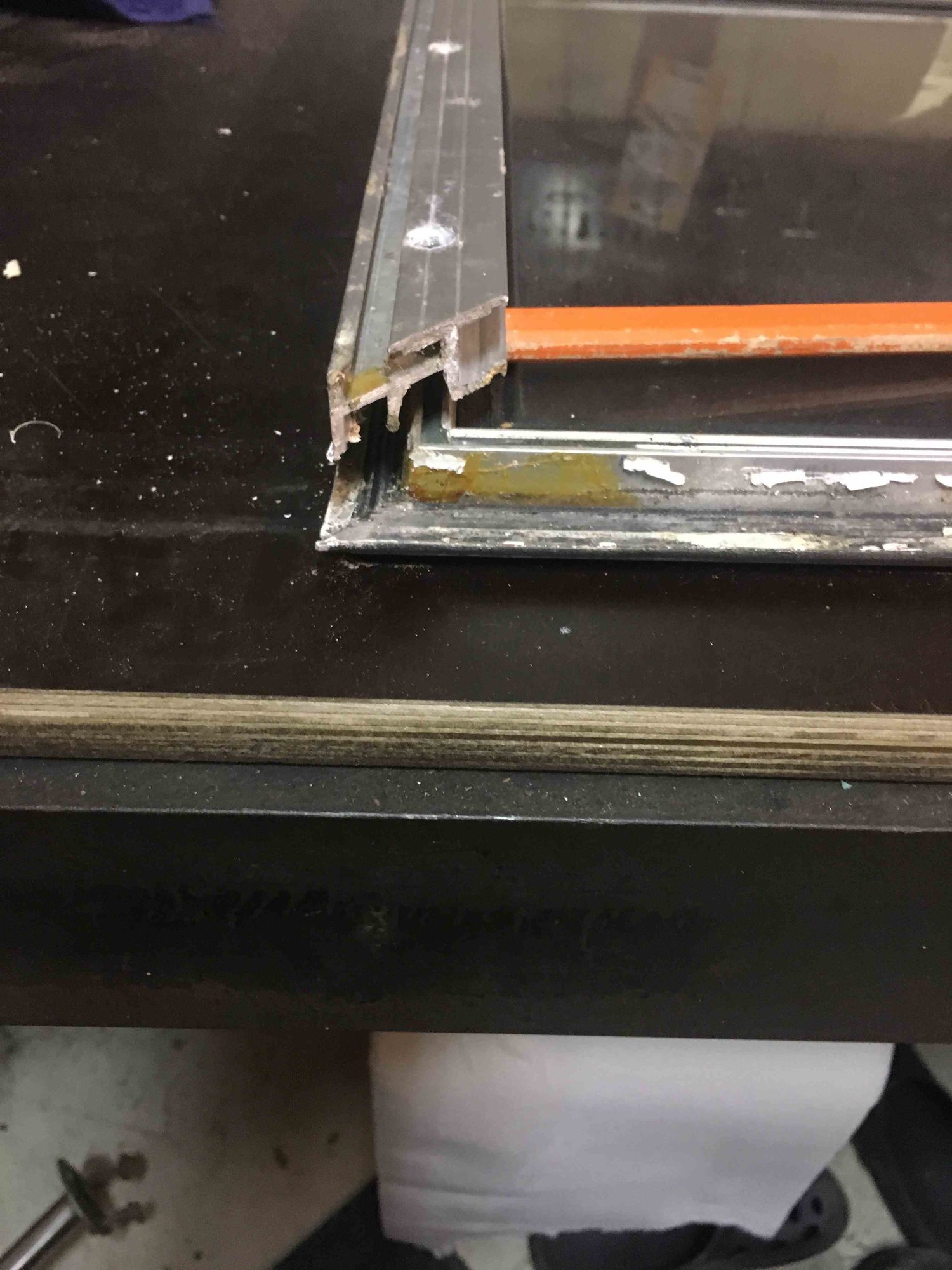

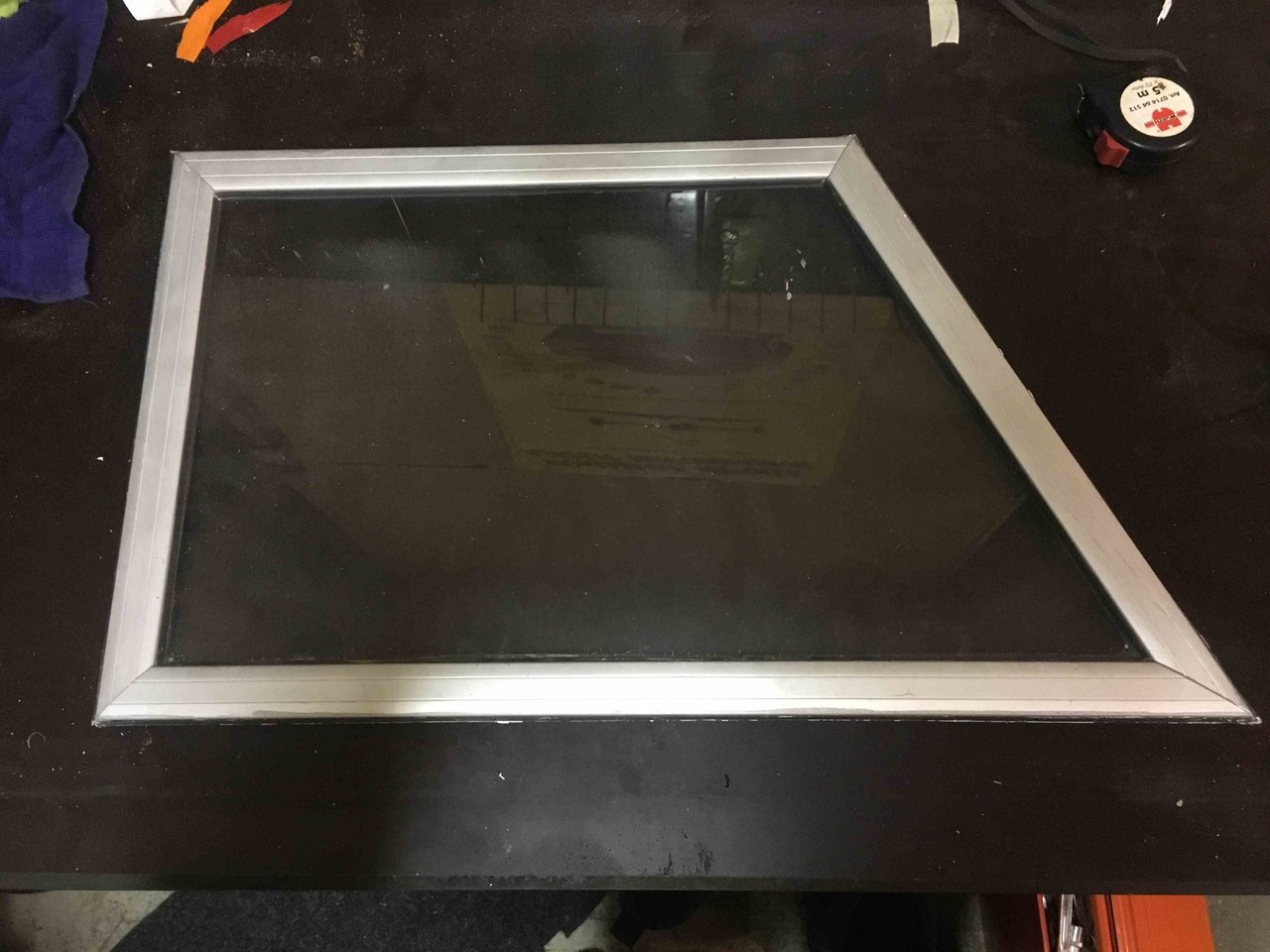

We have a Gullringen motorboat which we have started to renovate, here in Finland, at Lake Saimaa, if anybody knows some Finnish geography. We have some problems, because the boat was apparently built in Sweden, with the cabin's windows and the rub rail (or fender list) which goes along the deck (right in the corner between the deck and the side) I've attached a couple of pictures, firstly some pictures of the boat, also on the fender list which was there when we bought it and also on the window's foots.
So in a nutshell our questions and interest are:
-Does anybody have information on the possible year (roughly) when Gullringen were made with aluminum
-Is there some company in Sweden from where it is still possible to buy these window foots (and seals)
      The measurement in the windows foot is 30 mm width and 4 mm is the wall thickness
-Is there also a possibility in Sweden to buy that kind of fender list, which this boat had on before?
In addition alll history data on this particular boat is more than welcome.

The aluminium window frame is the same as I have on my Gullringen. They can be repacked with new rubber mouldings. Try to source it locally. I bought some from Kuntze.se, but there is surely a similar store in Finland.
I don't think the frame itself is available from any stores I've seen.
Hi,
Thank you for your response! We did find the window list, and all the windows are in place. It is shaping up to be a very nice boat 😊
