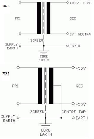

Hitta en tråd ang. jordproblem och skillnaden mellan  2 x 55V / 1 x 110V.
Systems
There exists within the power distribution world two different types of 110V supply system. Care must be taken to ensure the correct transformer is chosen for the application. Otherwise there is the possibility of creating a short circuit when connecting equipment specified for the alternate system and causing damage.
Type 1 (110V Mains System)  Fig 1
This is the 110V live, neutral and earth system used for electrical distribution in the United States and other countries. It is a similar to our UK 240V mains system merely operating at a lower voltage. The transformer coil has two output leads, Live and Neutral, The neutral lead may be connected to the supply earth.
Type 2 (110V Site Safety System)  Fig 2
This is the 110V CTE or 55-0-55V system. In this system the 110V output coil has a centre tap in addition to the two leads at the ends of the coil. The centre tap is electrically wired directly to the system earth. With this system a lead must not be connected to one of the ends of the secondary coil to define the neutral as this will create a short circuit within the winding.
This type of system is used for power tool operation throughout Europe. The environment in which these items are used is generally considered to be hazardous with the potential for damage to the equipment that could expose live internal wiring. The centre tap of the system being earthed limits the magnitude of an electrical shock under such circumstances to 55V instead of the full system voltage of 110V

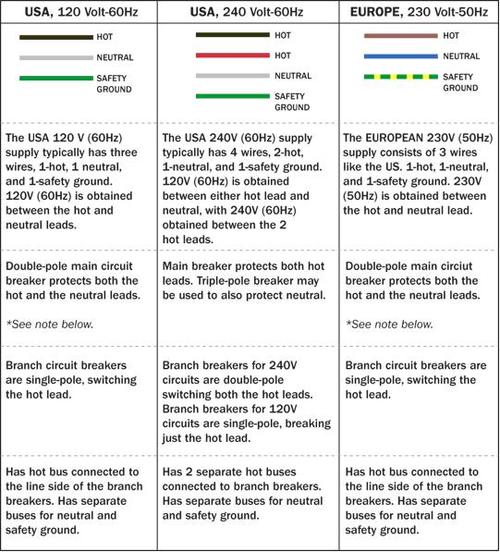

What happens when I take my 120 volt US boat to Europe and want to plug in to 240 volts?
Boat electrical systems in US and Europe
European boats tend to have smaller shore power systems than are typically found in the US.  Even boats of 45ft (15 meters) will often just have a battery charger, water heater and a few AC receptacles. In the US it is quite common to have air conditioning, refrigeration, microwaves, TV's and all the comforts of home and so power requirements tend to be more demanding.
Typical shore power in the US and Europe
For small and medium sized recreational boats cruising in  Europe it is normal to find a shore power connection with a 16 Amp service delivering 240 volts at 50 Hz.  Larger boats in larger slips will encounter a 32 Amp service.  The total power available from a 16 Amp service is 3840 Watts ( Watts = Volts x Amps) and from a 32 Amp service is 7680 Watts.  The frequency of the shore power in Europe will be 50 Hz or 50 cycles per second.
In the US will find a 30 Amp 120 volt service for the smaller boats.  Larger boats will typically find a 50 Amp 120/240 volt service, or occasionally a 50 Amp 120 volt service.  The total power available from a 30 Amp 110 volt service is 3300 Watts and from a 50 Amp 120/240 volt service is 12000 Watts. In the US the frequency is 60 Hz.
Bringing a US boat to Europe
The least expensive way is to get a multi input voltage battery charger and use it to charge the boats batteries while using an inverter on board to continue to make 120 volt 60 Hz power as needed.  This allows you to keep batteries charged and use appliances on board as needed.  It works best for small power demands; if your boat has three air conditioners and a washer dryer this is not going to work so well.
The next way is to get a transformer to convert the voltage.  The snag with this is that transformers are big and heavy and expensive and won't convert the frequency. The frequency may not matter for many pieces of equipment but for some it could cause overheating or other problems. If you have a new boat under construction you can specify dual frequency motors for air conditioners and refrigeration and avoid this problem.
US boats going permanently to Europe will be required to comply with CE requirements.  What this means in practice appears to depend on who is doing the certifying.  If the boat is to be rewired at least it should be possible to keep most of the existing wires as they will be adequately sized to support the lower currents and higher voltage.
Differences in USA and European AC Panels
In the USA the two commonly supplied shore-power voltages are 120 Volts (60Hz) AC and 240 Volts (60Hz) AC. The standard in Europe is 230 Volts (50Hz) AC. All of these supplies are single phase, but there are differences in the supply wire configurations and consequently in the power distribution panel structure. The chart below illustrates the differences.
