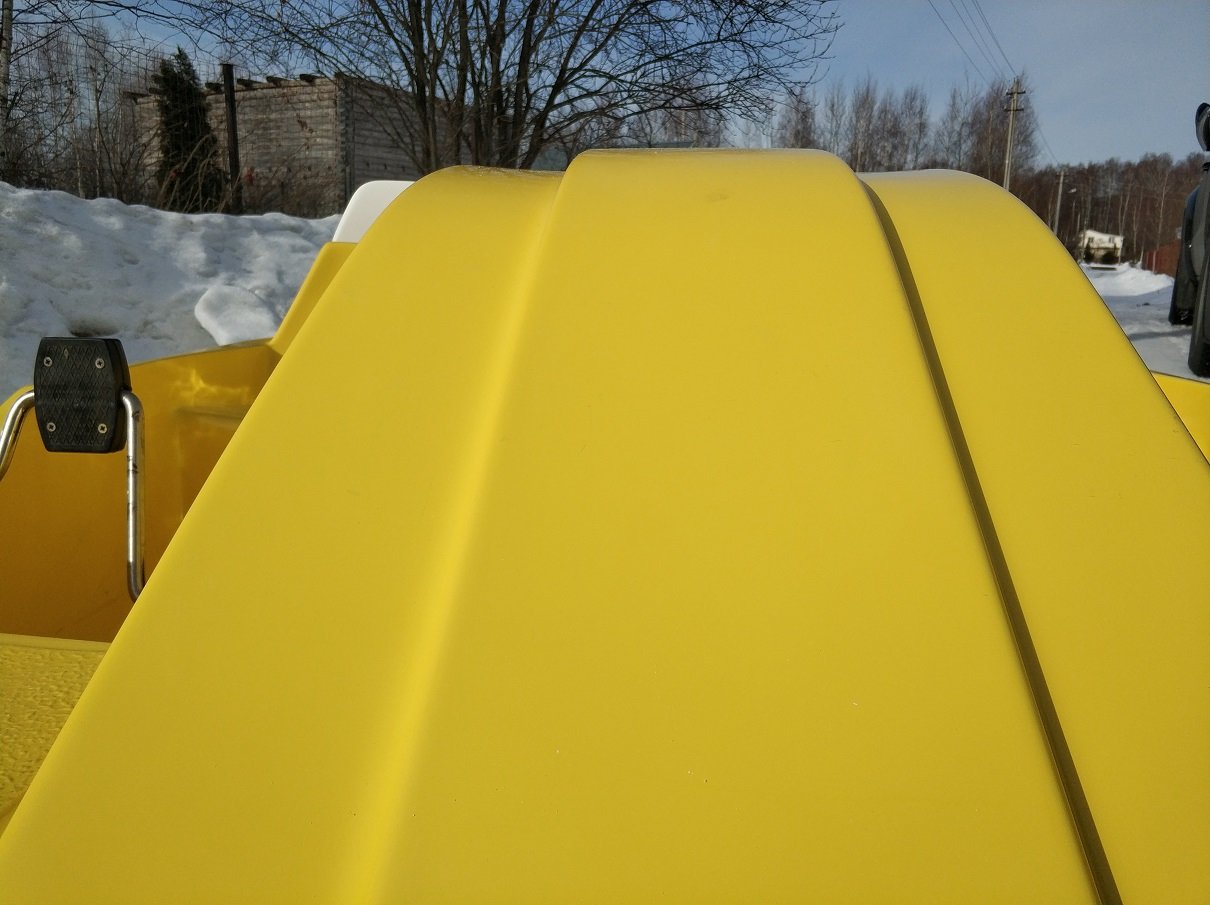

After washing, inspect the damage.
Damage is low, but a lot of them
All damage is treated with Dremel.
The color of the gelcoat is written by the boat manufacturer. This makes the selection.
Slight damage, need to fill in the gelcoat, a lot of damage in polyester resin and glass Mat.

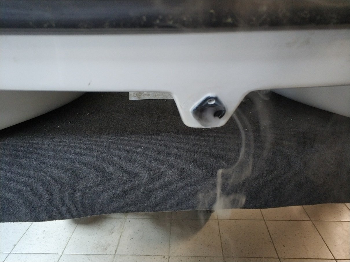

According to the customer, some boats took a lot of water inside during the season.
To prevent leaks, I make smoke into the emptiness of the boat.
